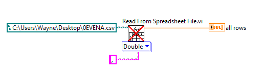

Read from Spreadsheet file reads only one column
I have attached an extremely simple VI and also a csv file.  The Read from Spreadsheet File reads only the first column.  I have checked the delimiters in Notepad and everything looks OK.  Any ideas?  Thanks.
(4,436 Views)
Accepted by topic author Wayne_B.
Ditch the space after the comma when specifying the delimiter.
(4,434 Views)
Thanks so much, Darin.  It worked!  I have no idea how the comma got there in the first place.
Wayne
