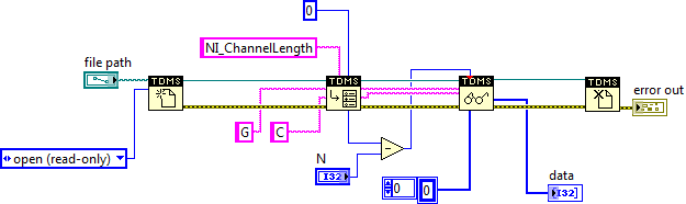

It's more safe to use TDMS Standard APIs if you are not familiar with Advanced APIs.
For example, to get the last N samples of a channel you can make a VI like that:
Message 9 of 10
(4,863 Views)
Thank You.  The online help did not indicate what parameters can be read.  The clue was NI_ChannelLength.
