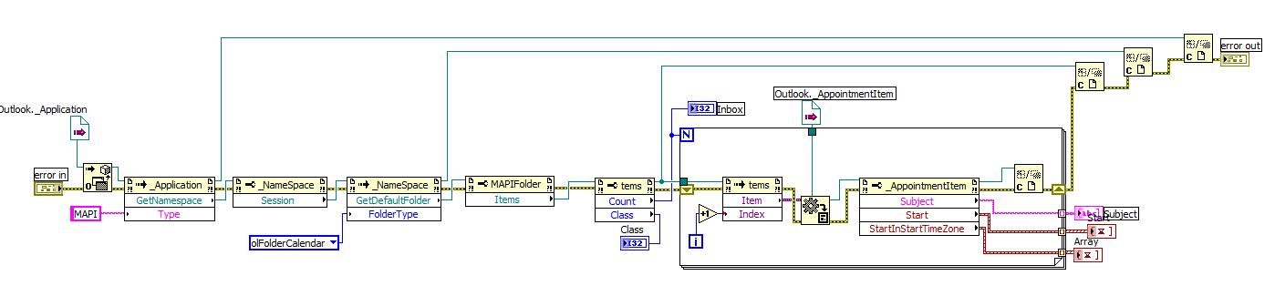

The code in the picture shows me only the calendar entries to the present day. How is it possible to read entries that lie in the future using ActiveX? thank you

This code works for me, the future appointments are displayed (Office Pro Plus 2010, LabVIEW 2015). The issue is probably not with the code.

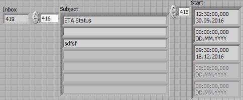

Thank you. Own created appointments in the future are displayed. Already existing appointments in the future, to which I was invited, are not shown. However, this function is sufficient for the intended application.

If you have recurring appointment items only the first one will be listed. Refer to this page on the subject.
