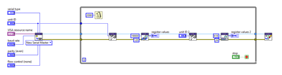

Thank you for the quick reply. Is this the serial solution that you had in mind?
I just tested it and get the following error message when reading from the second device:
Error 56 occurred at RTU Data Unit.lvclass:Read ADU Packet.vi:5030001
Possible reason(s): LabVIEW: (Hex 0x38) The network operation exceeded the user-specified or system time limit.

Yes.  That is what I was talking about.  (These two devices do share the same serial port, correct?)
Try making sure you can communicate with each one individually with its own program.

Thank you very much. I found the mistake and it probably had nothing to do with the Modbus Library. Somehow reading the registers from the Power Analyser (UMG96RM-E from Janitza) triggers a restart of the HART-Modbus-Gateway (HRT-310 from ICPDAS). While the program tried to read the registers from the gateway, it was in an initialisation phase and therefore it could not read any values.
I tried around a bit and found that this does not happen as long as I do not read 120 registers or more at once. I have absolutely no clue why that is the case. Reading 119 registers is no problem. If I had to get the values of just 100 registers, I would not even have encountered that problem at all.
I now split the reading of the 120 registers into two separate ones with 60 registers each and everything works perfectly.
