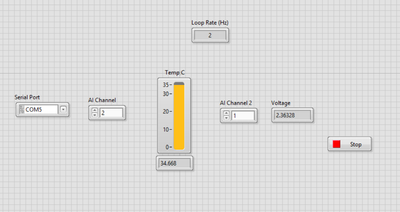

I am using Labview 2017 with a LattePanda, and my problem is that I can't read two analog signal.
I have to get the temperature and the luminosity, both sensor works fine alone but when I want to make them work together I have weird results. There is my example :

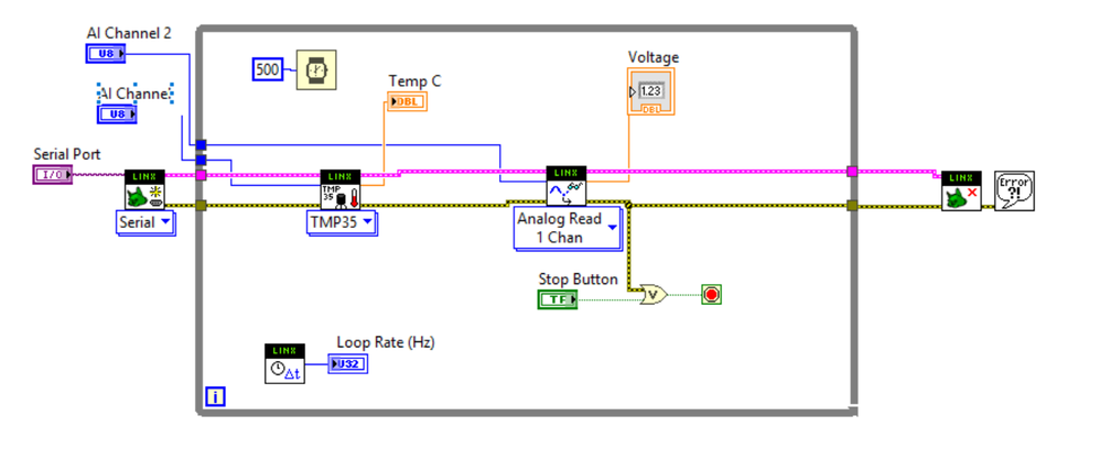

I have already test several way, and on this way I read the temperature one time and then I read the voltage of the light sensorfrontpanel_2analog.PNG
But the temp sensor vary very much and I don't understand why !
I hope you could help me ! and sorry for my bad english !

On your VI:
- why are there 2 close functions, when the connection to LINX is only opened once? Delete one of them!
- why are there 2 case structures? Why don't you use just one case structure and put one of the sensors in the FALSE case?

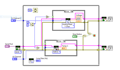

I tried a lot of way to make it works and here I read one sensor on every impair loop and the other one on pair loop. I did this to "separate" the reading of sensors. But I don't know if it was good
Responseforum.PNG Is that the way you wanted me to do ?
I already tried this option but it still don't work 😞
