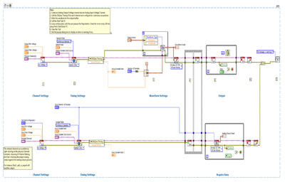

I am new to LabVIEW and trying to read the output of this VI.
I am using this reference. Can anyone help please.

I have modified as per the reference, but couldn't get the expected output.
The AO is to be controlled as per my "WILL" and not predefined, and would like to read those outputs.
The output I get with the help of modified VI is a sine wave.
I simply want to read the Analog output, given that the fan output voltage hence the speed can be changed as needed.
Are you using a simulated DAQ?  You will get a sine wave for any AI task from a simulated DAQ.  In the read hardware, this should work.  Of course, I am assuming you are setting the AO channel to "PCI-6221/ao0" before running this.
