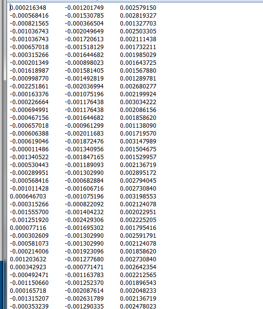

yes, attached a screenshot of the file.
I tried to upload both a file with 3 column and with 1, but it did not work anyway.
Can't upload the whole file because it is more than 5 MB.

So, the file has 3 columns, but how many rows?
