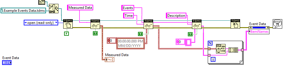

So if I understand this correctly there needs to be a TDMS read function for each channel recorded?
No.  The first one is reading many channels.  In this case it is getting the waveform data from all the channels in the Measured Data group.  You could also supply an array of channel names if you wanted to be more specific.  But all of the channels from a single read must be of the same data type.  That is why the other two reads are seperate.
