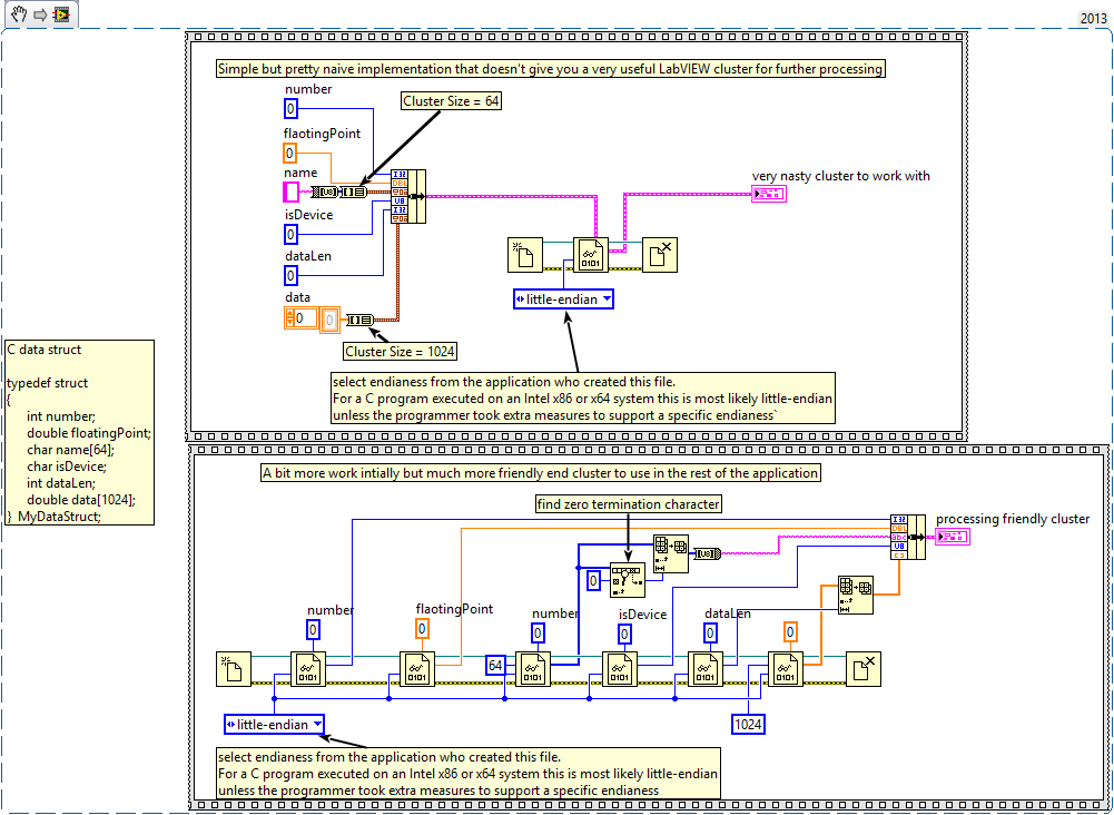

This should give you an idea of quick and dirty and a bit more elaborate but truly useful. Smiley Very Happy
However, please note that this sample assumes byte packing of the data structure in the C application. This means every element inside the structure follows immediately the previous element.
With default compile options, most C compilers nowadays would align each element inside the structure to the smaller of the two values:
1) its own element size
2) usually 8 byte
For this example this would mean that there are additional 4 bytes between the number and FloatingPoint element, as well as 3 extra bytes between the isDevice and dataLen element. No extra bytes between the dataLen and the data array though, as the doubles inside the data array already align on 8 bytes naturally.
Rolf Kalbermatter  My Blog

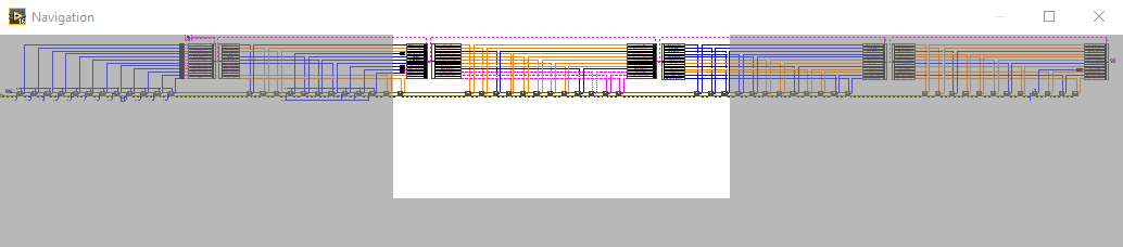

I feel like the resulting code belongs in the Rube Goldberg thread...

What about the idea to write subVIs for common data elements? Smiley Happy
