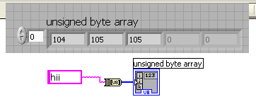

hii
Message 3 of 14
(6,100 Views)
Naveen Santhosh wrote:
hii
Could you please elaborate somewhat 😉

Message 8 of 14
(5,934 Views)
how to plot ascii data while it is coming from the port
the scheme said earlier works with a predefined string
kindly some one respond if the solution is known
