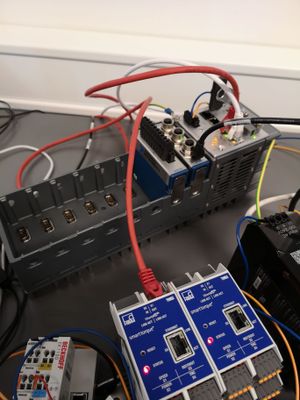

Hi GerdW
Please see my attached picture which is my setup..
I have the cRIO 9047 and this is connected to the etherCAT sensor modules. Is this possible?
I don't have an EtherCAT chassis..

Hi
In EtherCAT you typically need an EtherCAT Master e.g. TwinCAT from Beckhoff or some other EtherCAT master e.g. NI. In case of NI you would need the EtherCAT chassis for implementation.
There are many approaches possible.
One would be to turn your PC into an EtherCAT master (I only can talk  from the TwinCAT point of view) and read the data via TwinCAT ADS to your LabVIEW application. (20kHz will not be possible without a few buffering "tricks")
An other option is to write a minimal EtherCAT master on your own. This is very tricky because you need to implement the EtherCAT protocol into your LabVIEW application and will also not help to overcome the speed problem without many tricks.
So from my point of view it is a hard task to achive the result you want to have.

@nottilie wrote:
Hi
It is also a very difficult task from my point of view... I have a Beckhoff PLC which I could use for this EtherCAT master. But how do I read the data to twincat and from there to labview by using buffering tricks??
