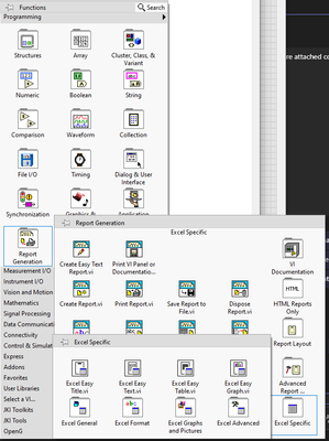

Look into the Report Generation Toolkit. To get to that, go to the Block Diagram, right-click on any white space, then go under Programming - Report Generation - Excel Specific.

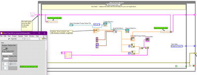

I don't really have much code written yet.  I am just experimenting trying to do the read part of it.  You can see where I read in 2 arrays, one called Simulated Torque Values and the other Brake data.  The first column of the Simulated Torque Value is actually degrees and the 2nd the torque value I would like to simulate.  This torque value would be used to control an electronic brake which would create a torque on the shaft based on the degree reading from an encoder.  The electronic brake is controlled by a voltage output that is proportional, but not linear to the torque the brake applies to the shaft, so I am reading that data in as well.  The 3rd array is just experimenting with finding the proper torque for the given angle.

So far you are not reading anything, so attach a typical input file too.
All your booleans seem to have the wrong mechanical action. Why not use the boolean text for a functional hint and keep the label concise?
What "control" did you have in mind in your original message? All you need to do is place the read data into a shift register and it will be available to all other cases via linked tunnels.

Good thing you started from a State Machine template.
There is a shift register (the rose one) that is used to store data accross all states you're coding.
Update the type-def of this cluster to include your arrays in it. Then read/write into the shift register wherever you need.

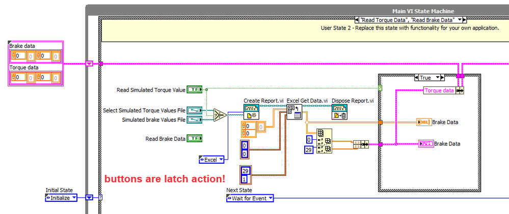

You can avoid all that duplicate code by reading both files the same way. No FOR loop needed.
Here's a quick sketch. (Since some of the plots are inside case structures, you should set "clear indicators when called". Also all buttons should be latch action so they reset to FALSE once read by the code. etc.)
For analysis, just unbundle in the relevant case.
Since these are all fast cases, you could use the event structure directly for all actions. No nee for the case structure.
