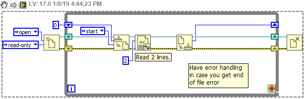

Does the proprietary program ever modify the data you would have already read in your LabVIEW program?  (Does LabVIEW open it read only mode so that it doesn't throw and error when the proprietary program has it open first with the write privileges?)
What you said in your last paragraph is exactly what I'm telling you to do.
First read, set file position to 0, read X  # of bytes.   Get file position and put  in shift register.  Call it Y
Next read, set file position to  Y, read X  # of bytes.   Get file position and put  in shift register.
Continue.....
Example_VI_BD

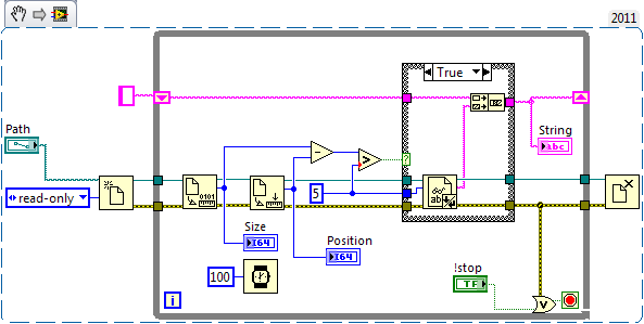

Do you need to store old position if you do not close file? It continues read from previous position on next iteration
I would add a check if file has enough data to read
read file.png.
You can edit  file in notepad in parallel, when you save it, this vi reads extra portions (5 bytes).

Good question.  I was thinking of storing the position because I wasn't sure what the file position would be considering a different application is manipulating the file in the background.  If the position is a property stored for the file within that LabVIEW file reference, then I guess you don't need to.  If the file position is a property that gets modified when the other application adds to the file, and what if that proprietary application happens to be another LabVIEW application, then can you trust the file position remained the same?
I'm guessing you are probably right, but I'd have to experiment to prove it.  And even if that is true, it doesn't do any harm to reset the file position after saving the current position value in the shift register.
Good point about checking the file to see if there is enough data.  One thing the OP hasn't told us and we can't see without the code is exactly how he is reading it and then processing the results.  You have your read has a regular read of a given number of bytes.  I based mine on a given number of lines since the example of the data file seemed to be line based.  In that case, what if 2 1/2 lines were written since the last read?  I'd only want to read the latest 2.
One thing about your code is that you seem to be accumulating all the data file in the shift register as it comes in, and the OP said that he only cares about the latest data and is willing to discard the oldest.
The whole program will wind up being more complicated than the simplest version based on the minimal information provided, because there really needs to be protection in the reads to know that valid data is available to be read and that it is complete.  Not just something to read but it only happens to be about 1 1/2 lines and the important remaining 1/2 line hasn't been written yet.
