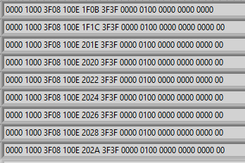

How do the strings look like in hex display mode?

Normal view:
Hex view:
Casted to varchar:
(EDIT: and for now I can't even reproduce that parital unicode conversion.)
