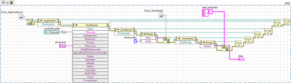

I want to export data from a password protected excel file...how it's possible?..need to use ActiveX functions? please help me

I'm afraid that Report Generation Toolkit does not support password protected Excel files.
But you can easily use ActiveX.
Attached you will find an example of such code.
(5,360 Views)
Thank you sir......thank you very much....it's working....thanks alot...
