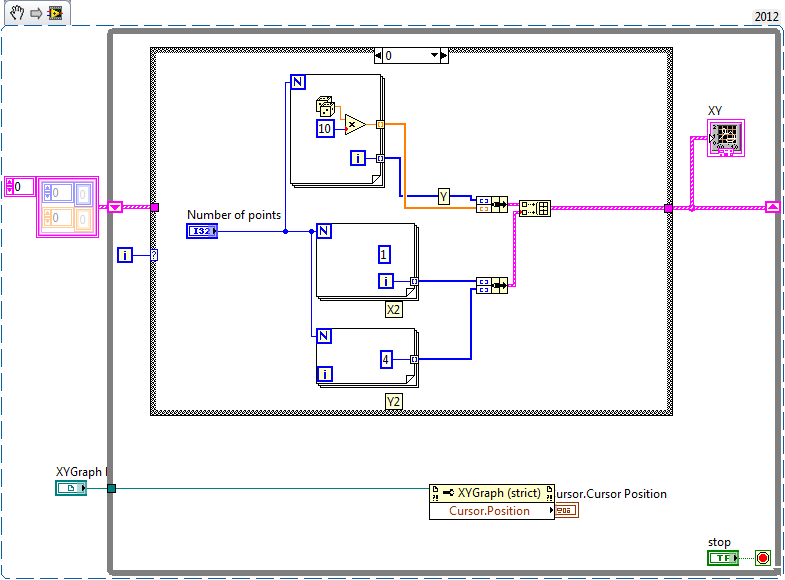

I have tried to look for answers to my question in the LabView Examples, but with no luck. Therefor I would like to ask you for help.
The question isn’t very long – is there a way to determine to coordinates of points in which two plots intersect? Like in the example vi – I’ve made a random function and a constant one – 4. There are places where they intersect. Is there a function/block that I can use to find the exact (more or less) points (X and Y coordinates) in which they intersect?

Hi Rockfor,
Please try this.
Create a cursor and obtain the coordinates.
I Hope its Useful.
Bijay

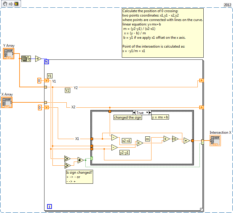

Hi Rockfor!
I created for you an example subVI, which can calculates / estimates the X coordinates of the 0 crossings.
Using this, you can calculate any kind of intersection.
I also extended your example code with this subVI and attached it to the post.
Feel free to explore, and if you have any question, feel free to ask.

Thank you, this seems to be the answer 🙂 i'll check it and let you know.
