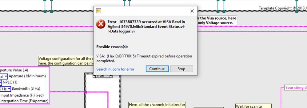

I am using Agilent 34972a with 3 multiplexer cards which are 34901a. I am measuring 2 different types of measurements.
Measurement 1:
I am using only 10 channels for days of measurements and there I don't have any problem.
Measurement 2:
I am using 50 channels here for the measurements and here I am always having a problem which is visa timeout operation before completion and it stops my data acquisition after 10 hours or 15 hours. I have to acquire the data for days of measurements.

What interface are you using on the 34972A? USB or Ethernet?
I have found the USB interface to be flaky on the 34972A units and recommend using the Ethernet (LXI) interface exclusively.

I am using the USB Interface?
As I said I have had random timeout error problems using the USB interface.
Try using the Ethernet interface.

If I use Ethernet Interface, Do I have to change code?
How can I integrate an Ethernet connection, Do I need to have an Ethernet hub?

Well if your program is written correctly, such as having the end user search for and/or select the instrument at startup or if it's missing then you shouldn't have to change anything.
But if your VISA Resources are hard codded then yes, you will have to change some code.
Hub or no hub depends on your setup. If your computer has to be connected to a local network then you will need a hub and it complicates everything.
But if you just need to connect the computer to the instrument you will not need a hub, but you will need to set a static IP address on both devices.
  1. The addresses you chose are not important but must be:
    1. In one of the non-routable sub nets 192.168.xxx.xxx is the most common
    2. The first three octets must be the same 192.168.0.x
    3. The last octet must be different for each device connected and between 1 and 254
  2. Set your computer to use IP address 192.168.0.10
  3. Set the data logger to use IP address 192.168.0.12
  4. Subnet mask if it is not filled out automatically should be 255.255.255.0
  5. Don't worry about DNS server or Gateway addresses
After you set that up you will have to open up NI-MAX and create a new VISA Resource, Alias, etc. for the data logger on Ethernet (New Network device) Just follow the prompts it's pretty self-explanatory.
Once you have the new VISA Resource created you will have to change any VISA resources in your coed that are hard coded to use the USB port to use the new VISA Resource you created.
