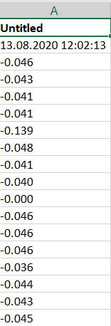

When I used write delimited spreadsheet file, The data saved as I need perfectly, but it is saving only in .xls version. Is it possible that it can be saved in .xlsx format?
When I used the TDMS format it is saved like this(attached Image), I would like to save each output in each column.
when I converted the file .xls to .xlsx, the file got corrupt.
Can you please tell me any suggestions?

Hi Shannara,
Oh boy…
Using WriteDelimitedSpreadsheetFile you DON'T create XLS files, but you create delimited text files! Usually they use either CSV or TXT file suffixes!
Excel is able to read CSV files as well as TXT files, and even assigns a specific icon for CSV files, but they are still text files. And you cannot change the file format by just renaming the file - this is pretty basic knowledge, not even related to LabVIEW…
Btw. LabVIEW brings functions to create XLSX files, see the RGT (Report Generation Toolkit) palette! But still creating CSV files is much more easier…
I don't think TDMS supports string arrays as it is intended to store numeric measurement data.
And it has some other internal data formatting, don't even get fooled by looking at those TDMS data using the TDMS plugin in Excel…

Thank you so much for the answer.
 In the end, I have to process the data, like import the data as text/CSV in excel and then convert it into an excel sheet.
Am I right?
