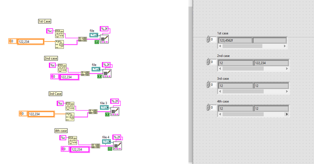

I have tried different cases for decimal correction, it didn't work. can you please tell me, how can I solve this problem?

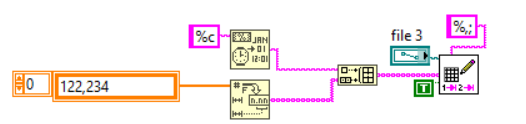

Message 45 of 80
(2,099 Views)
Hi Shannara,
still not right.
%,; just specifies to use the comma as decimal separator, but there is no information on how to format the floating point number!
Use %,;%.3f - and read the LabVIEW help on formatting codes again!

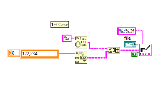

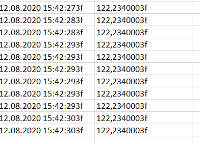

HI GerdW,
Sorry for disturbing you, I still didn't get the solution for it. I have got the values like this.Unbenannt.PNGUnbenannt.PNG
