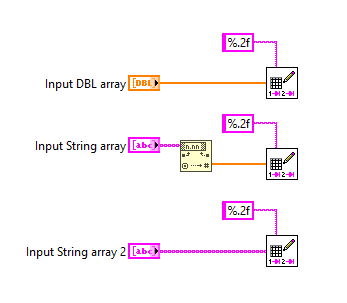

The "Write Delimited Spreadsheet.vi" has a "format" string input on top. This lets you set the written format. In your case, using "%.2f" should get you 2 decimal places.
(Disclaimer: I don't know much about localization - if your system uses commas instead of periods for decimal separation, you may need to use "%,2f", but I really have no idea)
But, here's what I'm saying:
If you can get your data as doubles, use the top example.
If it *has* to be a string array, first use "Fract/Exp String To Number" to convert your string array into a Double array, like the second example. 
Or, maybe you can just put the "%.2f" directly on a string array - based on the Help, it looks like it would work, but I'm not sure.
The third example does not work. So don't do that.
There are also ways of modifying Strings in a String Array directly - if that's preferable, we can explore that route.

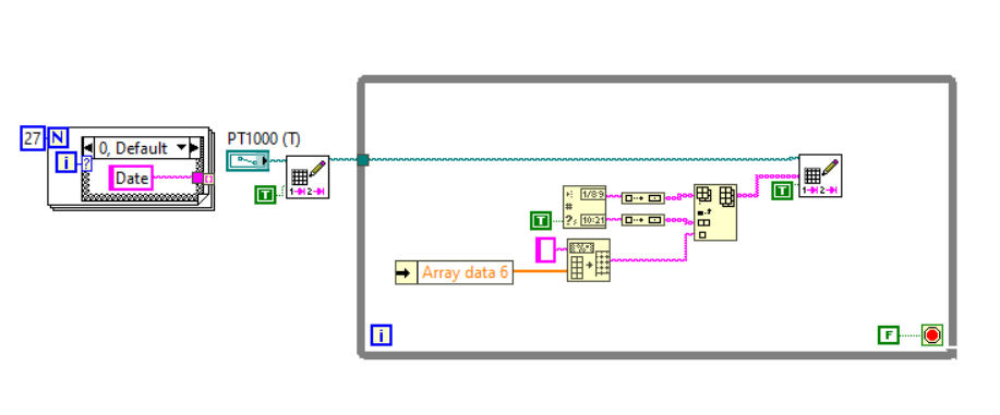

This is how I was used to save the acquired data.
Message 39 of 80
(2,178 Views)
Hi Shannara,
May I know is there any mistakes here?
Mistake: instead of attaching real code (aka VI) you just show an image of part of your code…
Mistake: formatting the numbers using ArrayToSpreadsheetString, then again formatting data using WriteDelimitedSpreadsheetFile…
Mistake: using InsertIntoArray instead of BuildArray when you want to build an array…
Simpler:
