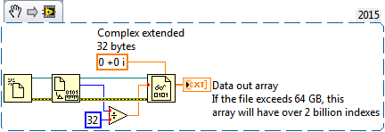

I need to see your code to see if it is indeed the case, as I don't know what you have got wired into the "Read Binary File" function.
Here's what might cause your problem:

(7,361 Views)
The attachment shows the relevant snippets of code.  Nothing special.  I open a file, do repeated binary writes of a large array (structure shown on bottom left; for each write, "prepend array or string size?" by default being true means the size of that array is included), and except for the very large file, I have no problem reading in that structure.  The snippet on bottom right shows how I open the file (generating error 116 for the very large file).

Without actual code it's very hard to know for sure, but I see an array of a cluster of 10 elements wired into the top.  Yes?
I'm going to go ahead and guess that they're all 32 bit integers, but again, it's hard to see to know for sure.  But 10 elements at 4 bytes each makes each element 40 bytes.
That means that as soon as you try to read a file of a size over ((2^31)-1) * 40 bytes, you'll run out of array indexes.  That's 85899345880 bytes, or 80 gigabytes.  Nicely in between the values that do and don't work.
I suggest that you revisit the method of splitting files into smaller files and just make sure you slice them evenly on a multiple of 40 bytes (or whatever size your cluster is, if some of the numbers in there are not I32 numbers).
