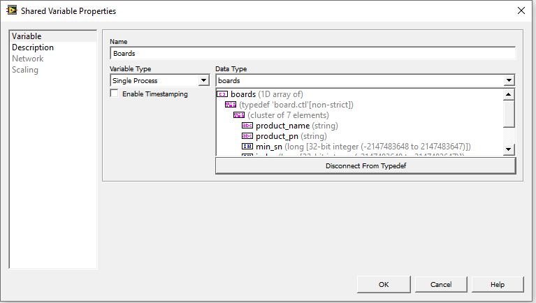

Hallo Jay,
I tried something similar without luck. I needed to shareboard profiles data between several VIs in this project so I tought to use a shared variable Boards (an array of cluster) defined in this way:
I can access such data from every VIs but it seems that writing on this variable has no effect.
Message 8 of 13

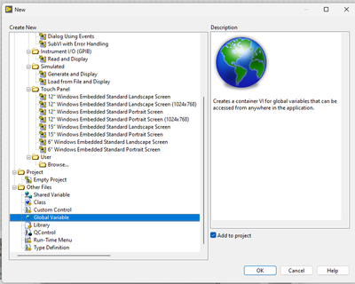

Not a Shared variable. Global Variable.
