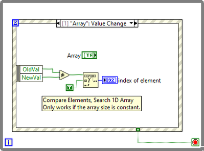

If the goal is to find out which of the "Array" values was changed (the boolean switches) then you can use something like this:
As the comment here says, it will return -1 when the array size increases, which isn't so helpful. So probably you'd want to make sure your array had all its values before you started checking (or make some inference from the array size changing and returning -1, since you know if this event fires then some value must have changed).
You can use the Index returned to Index Array over your "Shutter cluster array" if that's what you'd next need.
If you need the opposite workflow (changing "Shutter cluster array", then doing something about "Array") you can do something similar, although you'd probably want to then compare within the changed element to find out which part changed?
An example can be seen here: https://forums.ni.com/t5/LabVIEW/Event-structure-to-detect-value-change-of-a-control-within-a/m-p/83...
Let me know if I got completely the wrong goal/objective...

Note since you mentioned an Event Structure, I used one, but if you're working on an actual "Real-Time" system (as opposed to just wanting to do this responsively as things change, on a desktop system or similar) then you won't be able to use Value Change events in an Event Structure in most cases.
Then you'd want to do some sort of polling loop probably, but the same logic could be used (perhaps with a Feedback node to get the "OldVal").
Is Value Changed.vim (from 2017 onwards) would also work to find out if it changed (but not what changed).
