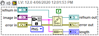

Even if you kept the current workflow, you'd be better to use the IMAQ Write String VI which converts the image to a String (essentially the PNG file in memory).  Then a fast way to store those would be to write to a raw file, and keep a separate list of "lengths" of each PNG-compressed image, something like this:
