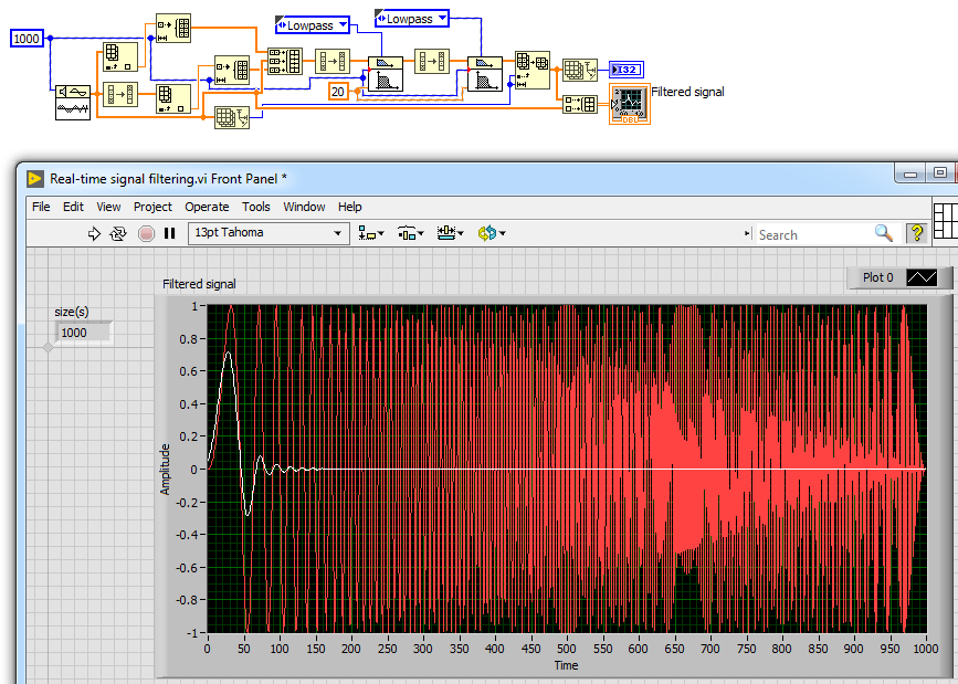

I am trying to apply real-time law pass filtering for my experiment. I have prepared a code using an artificial signal and adding noise. But when I add the code in real-time data acquisition system (code), it doesn't work well. Both codes are attached here.
Would anyone explain the errors or problems or miss connection, please?

Hi Milon,
Two notes:
- your filter is NOT set to reentrant, so it will mix data from several channels! To run your 3 instances of that filter independently you need to set them to "preallocated reentrant"…
- have you tried to (de)activate the "Transpose Array" option of your charts?
IMHO you are using way too much ExpressVIs (and Rube-Goldberg code) in this little VI. Try to stay away from those ExpressVIs…

Respected GerdW,
Thanks for your quick reply. Actually, I am not good at LabVIEW and I got some new term/word in your reply. Would you please mention the problems in my LabVIEW code or modify the code?

Hi Milon,
I don't see this when I use some test data with your filtering routine:
Btw. one of those InitArray functions was missing its size input…

Respected Mr. GerdW,
Thanks for your quick reply. Actually, it happened in real-time sensing. When I used an artificial signal, it was ok. But, in real time, at the end of every second, this data fluctuation is noticed. Would you please mention the missing 'InitArray functions'?
