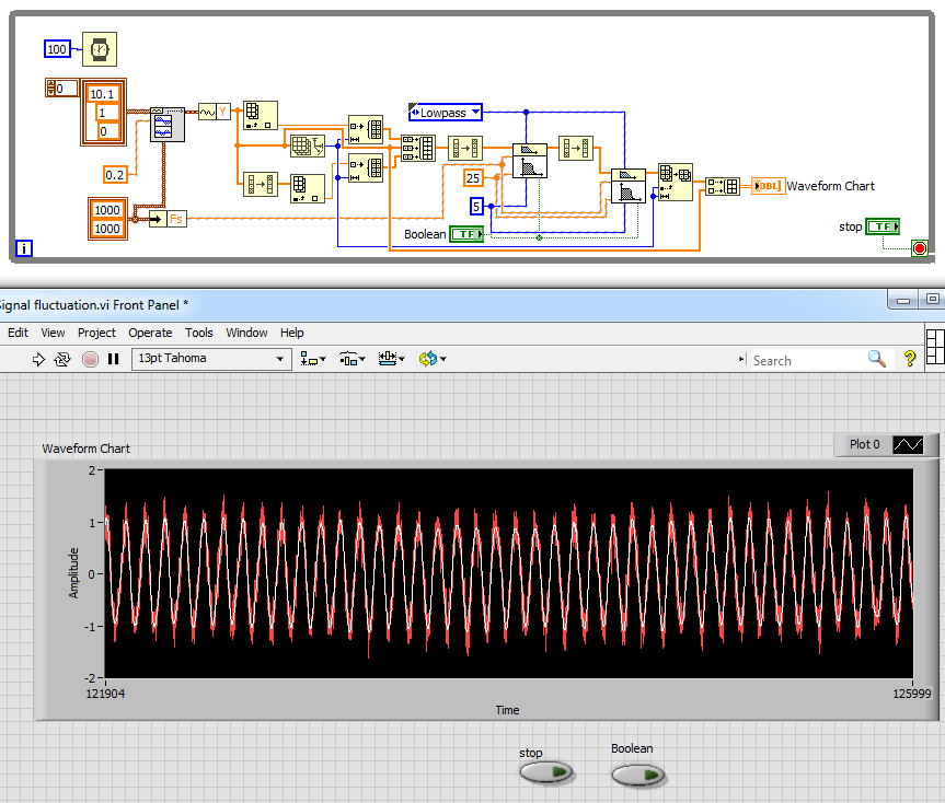

Respected Mr. GerdW,
I am still trying to solve the signal fluctuation. Although you explained that problem a nicely ( about "init/cont"), and I followed some examples, but couldn't solve that yet. I have attached the modified code here. Would you please check and give the suggestion for further steps...
Message 19 of 33
(2,404 Views)
Hi Milon,
no problem on my side - after correctly wiring all those array functions (again!):
Message 20 of 33
