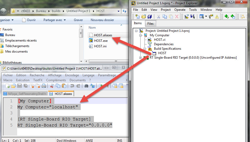

Hello Hazkel,
The IP address of your real-time target shared variable is located in the *.aliases file when you create an executable, so you need to change it there.  See below the example:

Thanks.
You are absolutely right when I work in development environment (i am working within a project) however after I compile my program and distribute it to other computer the only think I have is an "exe" file...
(5,060 Views)
WOW! so simple...
thanks a lot.
