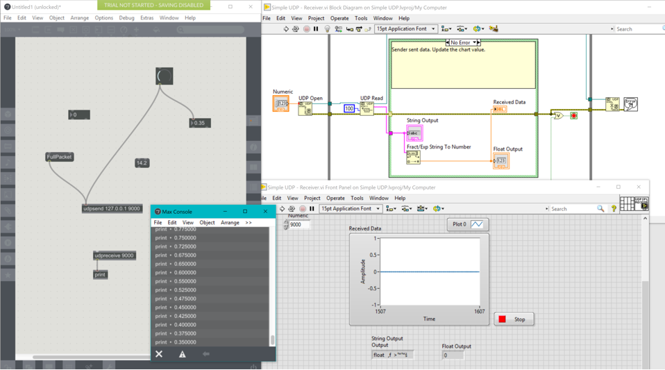

Then I am using a script to send OSC UDP messages out which contain the coordinates of that object as it moves. I am trying to receive the message in Labview and this other program called Max MSP for audio routing. When receiving in Labview, I want to take this data and store it for analysis later.
The issue I'm having is that when I send this data out, the received message (in string format) is not the number I am sending. Even when I use another program to send a simple floating point number such as 0.5, the Labview string received is something like: "float, f $" (without quotes).
I am using the simple UDP example for now and plan on modifying it, with an extra string display to monitor what is received. I know the message being sent isn't the problem since I can send and receive from Unity to Max.
Below, a screenshot showing a trial of this, Max sending a floating point number (with a dial) and Labview receiving on the right (with the string displayed). I know Labview is receiving the signal since as I rotate the dial and therefore change the number being sent, the time graph moves to the right as if writing "0" as it changes and the string displayed changes depending on the number being sent.

Your string output seems to be in a complicated format with words and such, so you just need to know what the exact format is in order to parse the value correctly.
Firstly, your string indicator is too short so we might not even see the entire string and your screenshot is scaled down so it all looks blurry anyway.
In order to analyze the string you receive it would really help if you could run your VI until the string contains data, then right-click the terminal...create constant. Place that constant (now containing a typical string) into a new VI, save it under a new name, and attach it here. (Do not paste the raw text here!)
To me it looks like a string with multiple sections. A header in clear text containing information about the datatype (float ,f ...) followed by a possibly binary string that needs to be cast to SGL or DBL. possibly followed by a termination character. Hard to tell the details.

Yes, receiving data fully works, even with the other sender. The string is not empty 😄
The only problem is the parsing and interpretation of the received string. I was trying to solve that by requesting the exact bits, but so far I have not seen anything. It would also help to see the documentation for the sender program. Do we have access to the source code? I assume that the sender is not written in LabVIEW.
