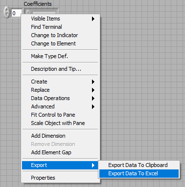

Mark,
If you are plotting the data - Right-Click and 'Export' the data to Excel or file....
Try that...
Does not need to be a plot. That works equally well for plain array controls or indicators.
(Be aware that the export truncates the formatted data to the resolution of the axis markers, so if they e.g. use "%.1f", the exported data only contains one decimal digit. 😞 (see also)

Thanks, you guys!! That worked, at least to the extent that the chart on the FP was displaying the data.
The Excel file contains 2595 data pairs, which is 2595 more than I had when I posted my question! If I may pry a little further -- when I right click on the displayed data and select "Chart History Length...", it reports that there are 16384 data points in the chart history. That's 13789 more than I now have in the Excel file. I'm guessing that the rest of those points aren't accessible; could one of you verify that assumption, or is there still a way to recover them?

Chart history length is the buffer for chart data. Once it is exceeded, the oldest points will vanish. Since you used less than the maximum, you have all your data.
(The default chart history length is 1024 point and you would have lost >1500 points with that setting. Fortunately for you, somebody changed the default).
