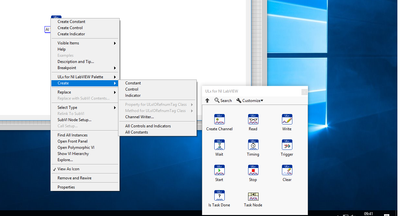

The problem I have now occurs when I try to follow the most simple tutorial to connect the DAQ for testing purposes. As I understand it, I must use the Create Channel function to create a communication interface between a port from the DAQ and LabVIEW to enable reading from and/or controlling the port on the DAQ. However, I can't assign a physical channel. The commands are greyed out. See images 01 and 02.

Initially, according to the RedLAB instructions I copied their ULx drivers into C:\Program Files\National Instruments\LabVIEW 2021. When adding any UL Extension function the the block diagram I received a Dependency Path warning, see image 03. The expected path contains the C:\Program Files (x86)\National Instruments\LabVIEW 8.5 folder instead of the LabVIEW 2021 folder. To resolve this I created the missing path and copied the ULx drivers into this folder as well. This got rid of the warning, but I'm not sure if this is a correct solution without 'side effects'. So (part of) the problem may still be related to the ULx functions.
