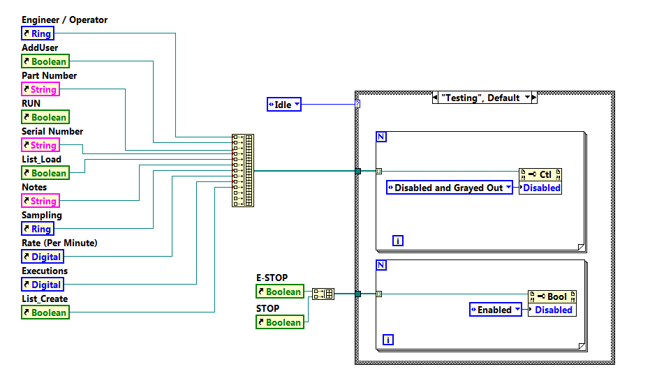

Is there any way to reduce the ammount of clutter on my Block Diagram when needing to Enable and Disable controls while tests are running? I know that I can place the case statement in a SubVI, but am looking for the best recommended method for reducing the clutter by listing all of the references. Using LabVIEW 2015.
Below is a small example of what I am talking about, there will be only more references to add as the VI devlops.

When you say that I can clustor FP items, say that I did, and that I have a group of controls such as the ones below in a clustor. I still have to generate reference constants, that are then placed into clustors. And if I want to disable them I would then have to bundle each reference into the clustor, and then unbundle and disable each control individually. I am betting that I am really missing the point here and would love further explanation.
Kellen
My main problem is not being able to place actual refrences in a Clustor.
(6,245 Views)

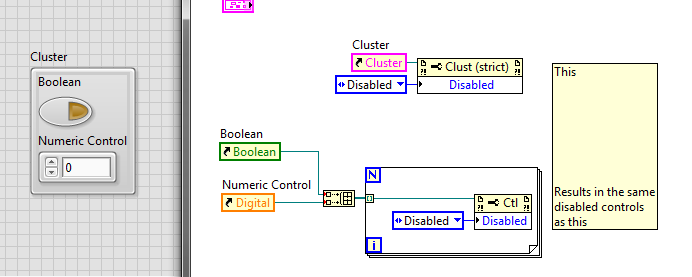

You're thinking about the carriage, when I'm talking about the horse. Your front panel items can be in a cluster and then you can use the cluster's reference to disable the whole thing. See:
You will get a slightly different looking front panel between the two options if you use Disabled and Grayed Out because when you gray out the whole cluster, the edges gray. When you gray out single items in the cluster, the edges of the cluster remain normal.

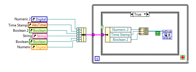

I basically store my control references in a cluster and when I need to disable/enable them, I unbundle the references I need and build them into an array.  Then I pass the array to a subVI that does the enabling / disabling.
There are some other suggestions here:
http://forums.ni.com/t5/LabVIEW/Faster-way-to-enable-disable-front-panel-objects/td-p/3141728/highli...

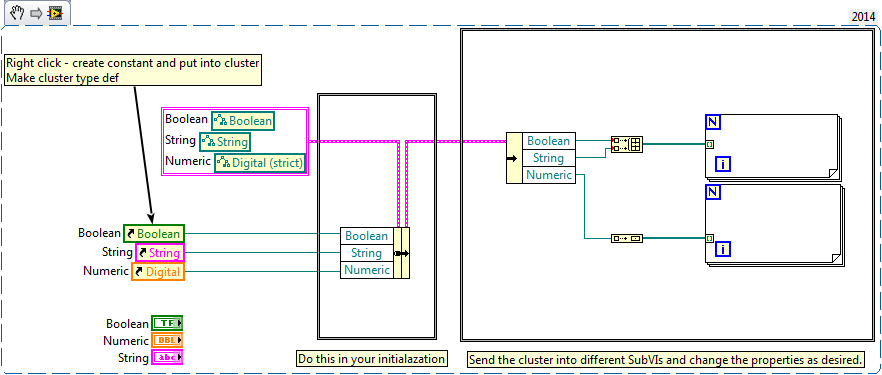

If I have a lot of controls I put them into a cluster. Then I just wire the cluster into the SubVI such as "Enable during test" "Enable during setup" and so on. The cluster will have to start with constants, which you fill in with the actual references at the initialization of your program.
(6,227 Views)
