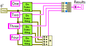

I'm worried that you are "barking up the wrong tree".  It seems to me that you are trying to build reentrant routines so that you can simultaneously access a Database and get the queries handled in parallel (as opposed to serially, one at a time).  Note that the easiest way to run four reentrant VIs in parallel is to simply drop four copies of the VI on your Block Diagram and ... run them in parallel!!
Running things asynchronously just means that the VI per se does not appear on your Block Diagram, and runs independently of the calling VI.
So the real question is -- does your Database support simultaneous queries -- can you ask it to do four things at once and have it finish in about the same time as to do the single longest query?  If your Database can't handle parallel calls, then there is nothing to be gained by calling it in parallel, with Asynchronous Calls or not.
