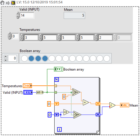

The application is to test vehicle brakes. In FPGA target, the FPGA.vi will only read&write analog IO's and PID control in FXP representation. converting it to DBL format global variable in FPGA_IO_RW_new.vi (using FPGA Read/write control) for calculation purposes and shared to HOST using shared variable. sub vi 'AVG TEMP.vi' is used to calculate average temperatures.
please find attached picture for vi hierarchy.
This is my first project in labview, please suggest any better way.

Your AVG... vi is not explicitly part of your project, but dependent on other VIs that are. As a first step, right-click on it and find callers, and see where the caller is running, then drag it into the section.
And yes, your subVI code is pure Rube Goldberg. For example your "=TRUE" just returns the input unchanged, so why is it even there?
cbutcher gave you one alternative and mentioned some others (conditional tunnel). I doubt you really want to run this on the FPGA. Average temperature readings don't dramatically change within nanoseconds. What is your loop rate?
