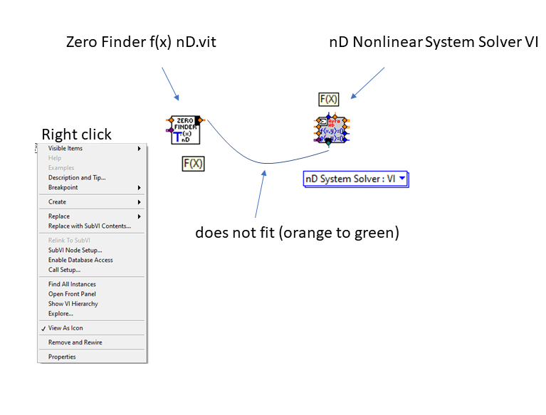

I added a picture. Hope it is understandable and there are no laughs :-). I have already worked with references. It is possible that I did not understand the LabviewHelp.

The model subVI does not belong on the diagram. Instead you need to create a strictly typed static reference to it
  1. Place a static VI reference
  2. Drop your model subVI into it (or browse for path)
  3. Wire the reference to the system solver (wire will be broken)
  4. Right-click the static VI reference and make it strictly typed.
(The model VI does not belong on the diagram of the toplevel VI because it is used inside the solver only, but needs to be interchangeable. It needs to be strictly typed because the solver does not expect some random VI, but a VI with an exactly defined connector pane. This also means, that you cannot e.g. delete controls or indicators of the mode Vl, even if they are not used, or the wire will break again.)
