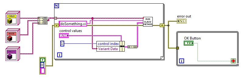

Okay, I've found a better solution. The key was discovering the LVClassLibrary.HasImplementation method. That will search the class hierarchy on a given class to find an implementation of a named method.
Here's a function (run class method.vi) to programmatically run a method for an object given the object, the name of the method, and the index and value for any front panel controls you want to initialise.
Here's how I call it:
I've attached the test project including this VI (run class method.vi). Look at other calling test.vi to see it in action.
