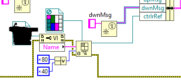

I'm launching with option 80 and 40, and the close ref takes 6 seconds even if I skip launching the VIs.  Reentrancy is preallocated.
here's the launch:
and the close (thats taking a long time) in the stop state:
