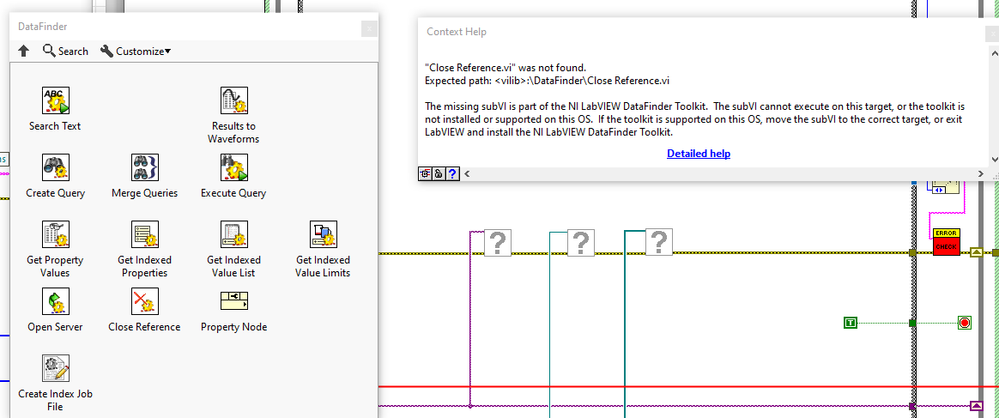

I opened a LV project from version 2018 with the LabView 2025 (Q1). Although the function list of LV shows the DataFinder library, the old vi's does not load the used DataFinder vi's at all. What I see is only an empty grey box. Of course I could manually exchange those missing vi's but there are so many it is kind of impossible.
I tried to add the vi search path directly to the path of the DataFinder library but no success. I also masscompiled my old project but also no success. Here is an example of such corrupted vi:

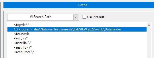

The added search path:

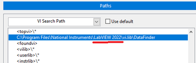

You set the include folder to LV 2022, is that intended? DataFinder was moved to the LVAddons folder (C:\Program Files\NI\LVAddons), which automatically shadows the LabVIEW install folder. Perhaps there is an issue with that.
See here about LVAddons: https://labviewwiki.org/wiki/LVAddons

Why did you add a "2022" search path for LabVIEW 2025? (Also is your 2025 32bit or 64bit?)
I don't think modifying the search path should be necessary, so something else might be wrong.
(567 Views)
I am using LV 2025 64bit. I added this additional search path only to see if LV finds the missing vi's - but no success. So I removed it again...

Currently I am using LV 2025 64bit the project I am using was made back in 2018 but very likely with LV 32bit. Could this be an issue? If yes, how can I solve it?
I have seen the datafinder toolkit is only availabe for 2018 as 32bit.
