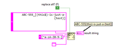

Using LabVIEW 2023, I am trying to allow only alpha numeric strings, and dashes with the Search and Replace String function. The regular expression is a simple one as far as they go, but I'm at a loss as to why this doesn't filter the parenthesis, braces and brackets, i.e. ( ) { } and [ ]. I even tried removing the trailing dash just in case it was confusing it as the start of another series, and the result is the same. I set the font used in the block diagram to Consolas so you could see that the zero is NOT a capital letter O. I have also tried the Match Pattern function and got the same result. I have even entered the expression into one of the online RegEx testers sites and it spots exactly the characters I want to filter.
Here is the regex expression:
[^a-zA-Z0-9-]

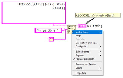

you need to set the replace all flag to TRUE:
