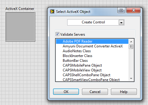

1 - Add ActiveX container and set object

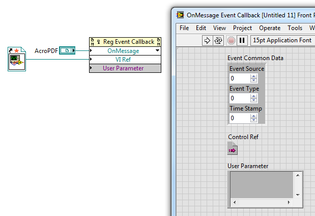

2 - Create Callback VI automatically

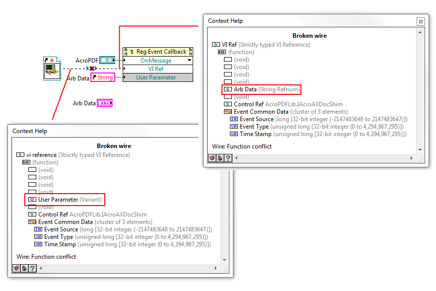

3 - Wire something to the user parameter input (wire will break)
3 - Change DataType.png#

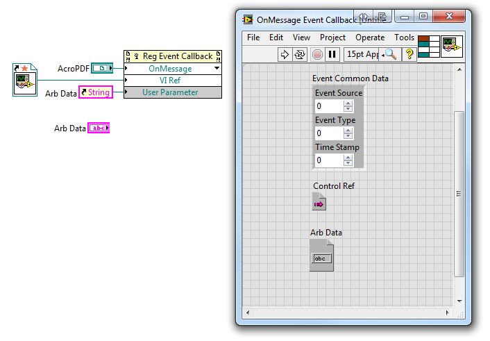

4 - Change Callback function to reflect this change (wire is okay again)

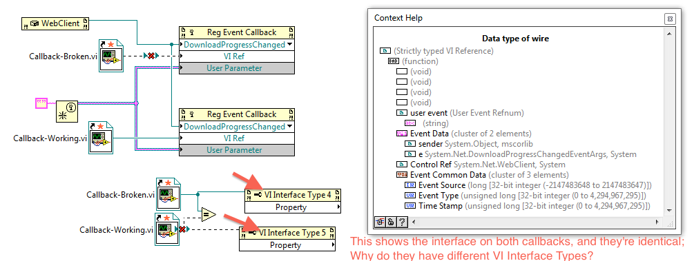

OK, I've uploaded three VIs: a caller, a callback that works, and a callback that is broken. Note that the two callbacks have identical conpanes.
Below the Register Event Callback Node, I have placed an "Equal?" prim to show that the strictly-typed VI references are not of the same type, even though they have the same conpane. Here's a screenshot showing the two VI refs having VI Interface Type 4 and VI Interface Type 5, yet my understanding would be that these should be the same type.
So, I think we're not dealing with any problems with .NET callbacks; it's a problem with my understanding of strictly-typed VI references and the concept of "VI Interface Types". Why are these VI Interface Types different for two seemingly identical VIs?
