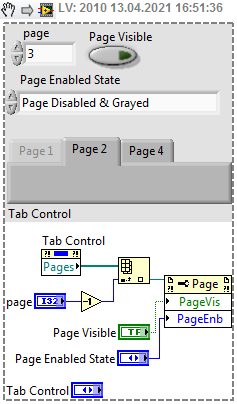

You can get the array of page references and hide the page you want or change the 'Page Enabled State'.
HidePages
