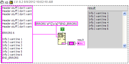

I used a character class to catch any word or whitespace characters.  Putting this inside parentheses makes a submatch that you can get by expanding the Match Regular Expression node.  The \d finds digits and the two *s repeat the previous term.  So, \d* will find the '6', as well as '123456'.

I put the Trim Whitespace in to clear out the spaces at the front and back.  Submatches are an easy way to get your piece in one shot.  Other folks might suggest better regular expressions that'll get what you want as the whole match.
