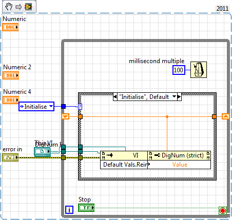

Or you could use something like this:

I'm still new to LabVIEW so I'm having a little trobule understanding the "DigNum (strict)" property node... Is that restricting the numbers in the VI from being set to their default value? When I run your code it doesn't work, I keeping getting an error that says "LabVIEW:  VI Reference is invalid."

Thats because the snippet tools strip the reference. Try the attached vi.

There is a separate reinit method for each control, so I would suggest something like the following (2011), which resets all controls except the ones in the array.
Of course, if you only want to reset a few controls, you build their references into an array and call the reinit method on them.
