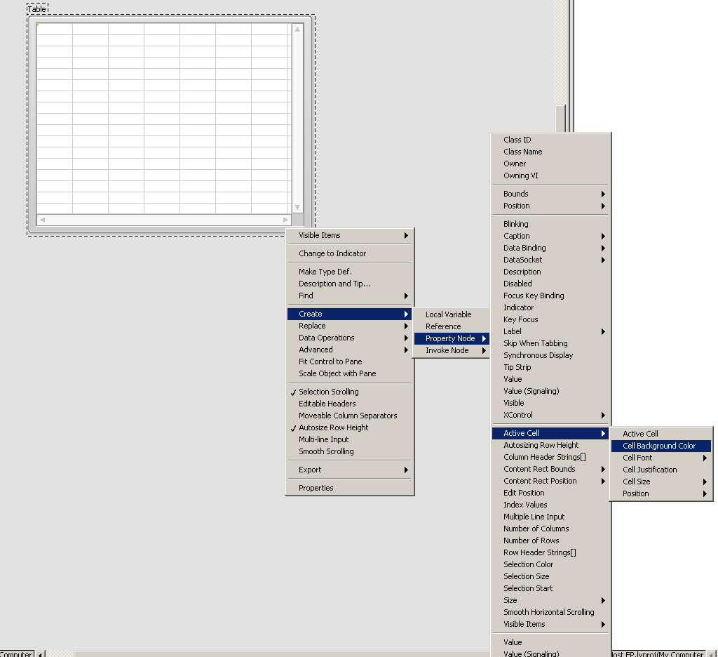

Hi Gary,
You can do this through a property node, right-click the table on your front panel and create a property node, from there you can select active cell and background colour. I have attached an image to help you through the process.
Regards
Andy

amfax, he is already doing that in a for loop, but for each individual cell, a slow process. My solution sets the background of the entire table which I believe is what he wants.
(6,481 Views)
Thanks a lot. It is working, it is really handy way to select all the cells in the table, I guess it is the same for multicolumn box.
(6,479 Views)
NGC miss read his question, neat solution tho!
