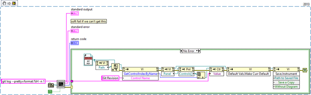

Get the current revision

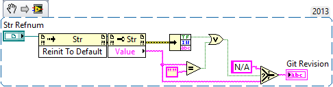

So here's the rub: when you run the update code above, it only works when the "current git revision" VI is nowhere in the call stack; therefore you have the run the update code before running your application to have it work as expected.
That's easy to do in an application builder scenario (just add the update VI to your pre-build actions), but less easy on the dev machine.
Should I just add that same git code to the "current git revision vi"? That might work but doesn't have the best code smell IMO

Looks like when the snippet saved in the "current git revision" VI, it disconnected the "git revision" indicator from those property nodes. Just link them back up and it should work as expected.
