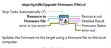

If so, you should be able to build a small LV or C application using the NI System Configuration API Update Firmware support.
You can then build it as an application and when you build the installer from LV just specify to include the NI System Configuration Runtime.  Your end user should be able to just install this application which will include the required runtimes (LV and SysConfig) and then use it to push out firmware updates to the targets.
Note there is no requirement to install NI-RIO on the host once this application is built.  Below is a simple example showing how to use the API to initialize a session to a target, find the RIO hardware and call update firmware.
