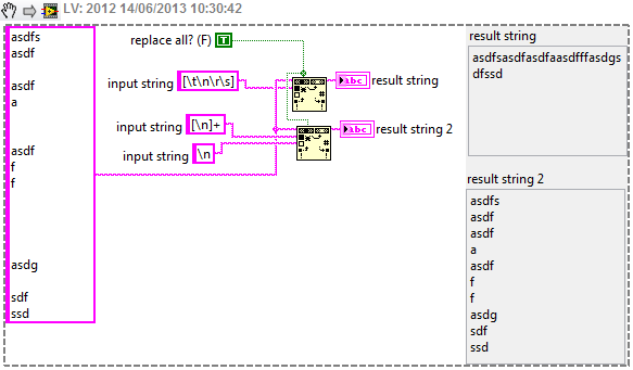

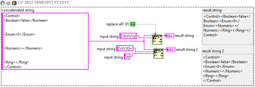

You could use regular expressions:
If this is not what you are loooking for, please post your data not a picture.

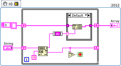

These are my VIs.
