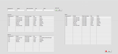

Good afternoon,
I'm trying to make the Actual list look the shape of the ideal list, but to no success
I need to check in the table is if the Equipment ID already exists
If there is, check if the seller is already on the same line
If it exists, it doesn't do anything on the list
But if the Equipment ID exists and the seller is not on the list, it must be added to the line in this format ;NameOfSeller concatenating with the name of the other sellers
I attached a print of the VI and attached the VI
Thank you for your help

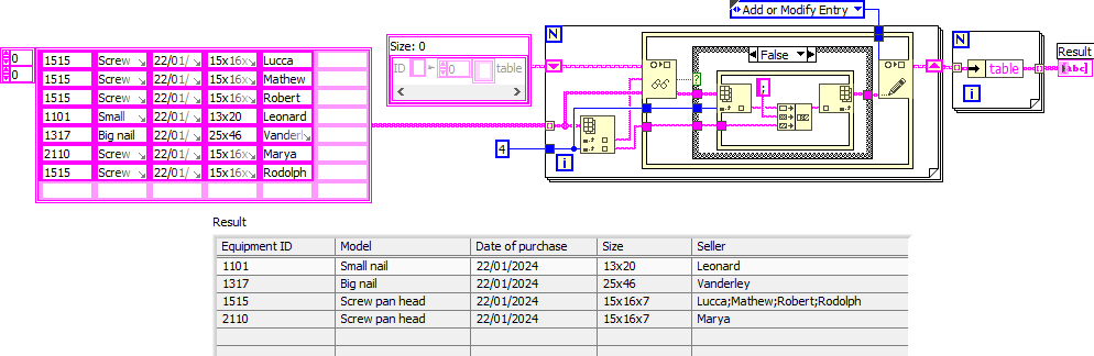

I would probably keep the data a MAP, e.g. as follows:
(this processes the original list but it will be easy to maintain the map with each new entry in similar fashion.
And no, you don't need any sequence structures or local variables for any of this!

Okay, alright
  • For any ID, are the second and third column guaranteed to be the same? If not, what should be done?
    For me the second and third column doesn't matter, but for the end user visualizing it is important.
Basically, what is needed is to check the equipment ID column, and if there are repetitions, group them into a single row
If there are 5 times the equipment with the same ID (e.g., 1212), it must be grouped on the same line and the name of the sellers must be concatenated, without repeating the names
And don't allow other lines with the same equipment ID
