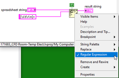

In the attached VI, I am attempting to remove all the white spaces from a generated "Spreadsheet string" block.  All the \t, \s, \r, \n.
I am using the "Search and Replace String" block but it does not seem to be working.  Can you tell me what I am doing wrong?  I have the "search" input as " '\' Codes display"
Can you assist me in removing all the white spaces?  Thanks!

Try this (right-click on the Search and Replace String function and tell it to use a RegEx):

Right click the node and check Regular Expression. That should do the trick. (It worked for me)

Right click the function and check Regular Expression
