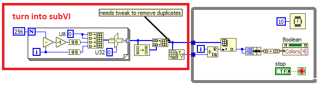

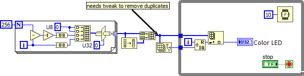

I would recommend to just pre-calculate the entire color array (ramp up&down) once before the loop and thn just index into it. Much less code and fewer places for bugs to hide! 😉
(... and of course I would use a colorbox. It can be made to look exactly like an LED but the code is much simpler and you don't need any expensive property node. The color is the value!)
