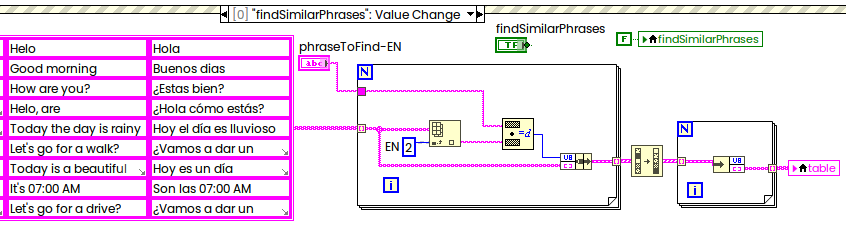

In assumption that the Levenshtein works properly, may by you can simplify this up to the following:
(679 Views)
